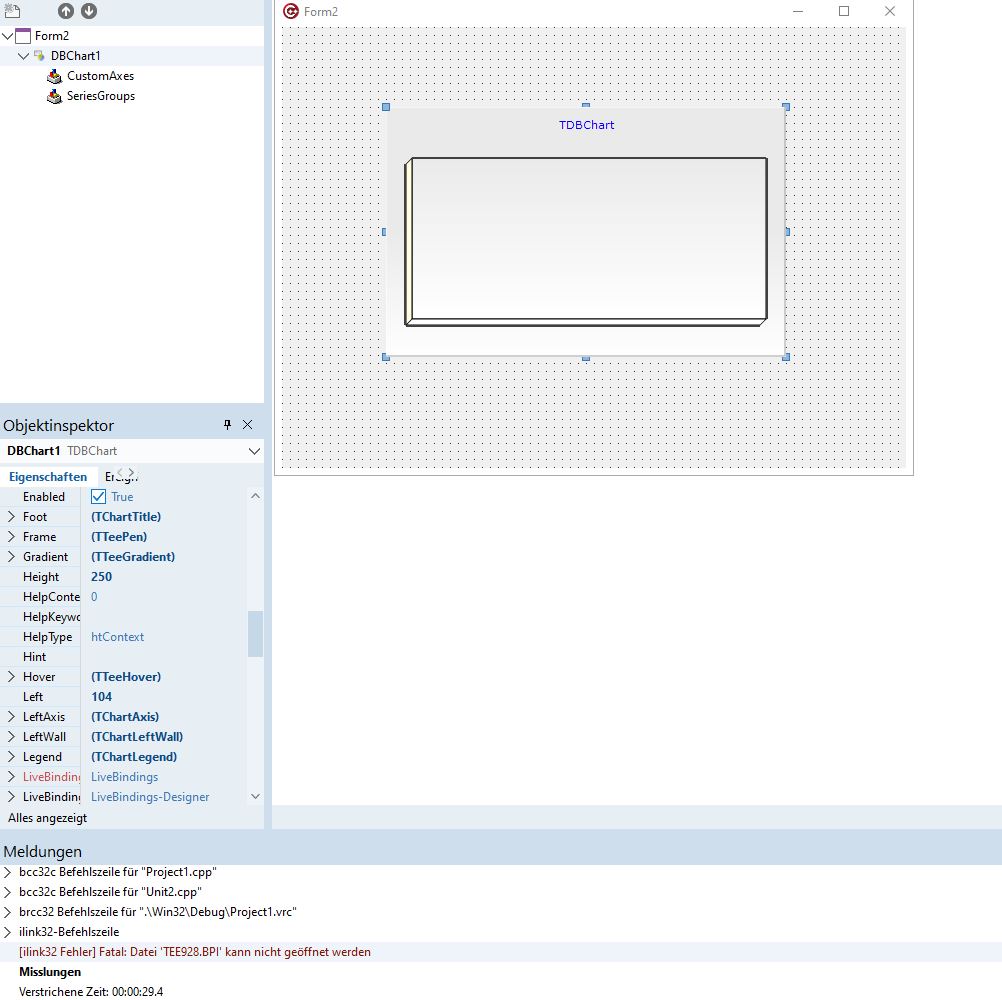

i have a Error when i try to compile a project.
[ilink32 Fehler] Fatal: Datei 'TEE928.BPI' kann nicht geöffnet werden.
I use C++ Builder 11 Upadte 3.
I have try this points: uninstall Steema, uninstall C++ Builder . Install new C++ Builder without TeeChart.
Install new TeeChart PRO.
Please Support.
Thank You
Peter
Re: Error after install 'TEE928.BPI' kann nicht geöffnet
Post by Yeray » Wed Jul 12, 2023 5:21 pm
When you right-click on that TChart at design time and open the About Box, does is show 2023.38 version?
Make sure the paths are correct.
