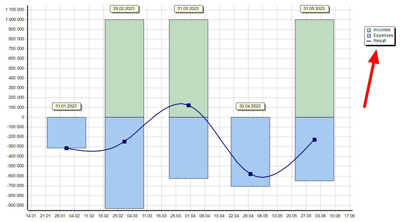

I don't understand why my legend box is truncated to show only the upper half of its last line. See attached screenshot. How can I fix this..?

The line series is drawn as a line in the legend. This is the expected behaviour.
You can fully customize the legend symbols as shown in the example here.
Or, if you just want to show a square for a line series, you can "hack" it: just add an dummy bar series with no data; set its title and color to those from the line series; and hide your line series from the legend with ShowInLegend:=false.
