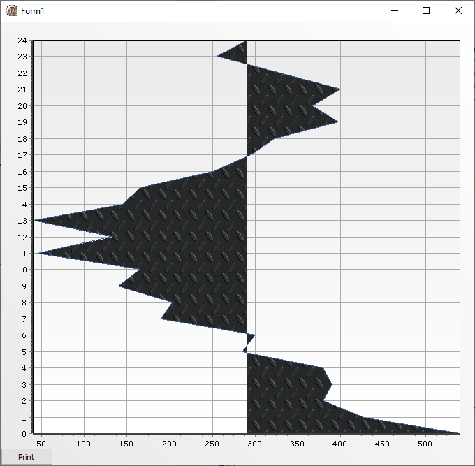

I would like to use embedded pdf export feature by using TeeSaveToPDFFile function, but I have an issue when an area on chart is filled with a pattern (using TSeriesBandTool). Indeed this area is exported as a blank area into the pdf file:
TeeChart screenshot:

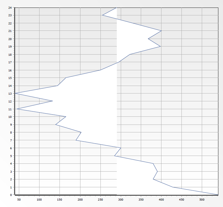

Pdf generated (with TeeSaveToPDFFile function) screenshot:

I'm afraid patterns aren't exported to pdf. I've added it to the public tracker (#2556)
The same happens with transparencies (#2275).

A workaround, which also works for patterns, is to create the pdf document "manually" (with TPDFCanvas), export the TChart to TBitmap with TeeCreateBitmap, and add that bitmap to the pdf document. Ie:
procedure TForm1.ExportChartToPdf;
var c : TPDFCanvas;
    b : TBitmap;
const PDF='C:\tmp\chart1.pdf';
  c:=TPDFCanvas.Create;
  try
    b:=Chart1.TeeCreateBitmap;
    try
      c.Draw(0,0,b);
    finally
      b.Free;
    c.SaveToFile(PDF);
  finally
    c.Free;
There was a range exception with new IDEs with this technique we've also just fixed.
