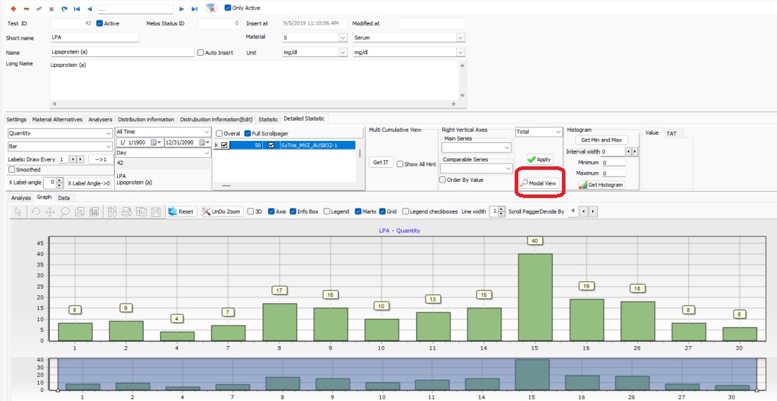

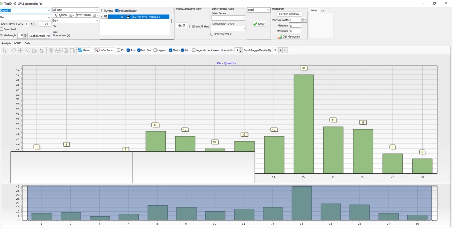

I have chart on some frame include some other frame components,
on frame i have button for seeing a chart and chart parameters component on some form:
code
var wc:twincontrol;
  mdiform.Caption:='TestID: '+self.eTextID.Text+'  '+self.lTest.Caption;
  wc:=pChart.Parent;
  pChart.Parent:=mdiform;
  bModalView.Visible:=false;
  mdiform.ShowModal;
  bModalView.Visible:=true;
  pChart.Parent:=wc;
when changing to modalview it show some rectangle on chart, i think it is about scrollpager but i don't know hot to remove that rectangle?

I solved it by creating scrollpager in code.
When we create scrollpage in designer it reproduce rectanlgle problem.
