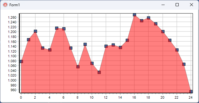

I don't know why I cannot find any documentation or previous posts about this, but do the xxFloat calls take world or screen coordinates? I tried sending world figuring that was the purpose and the points would be transformed to screen in the call, but it does not seem to be working.

All the drawing methods in the canvas use screen coordinates.
Here you have an example using PolygonFloat function:
uses Chart, TeEngine, TeCanvas, Series;
var Chart1: TChart;
  Chart1:=TChart.Create(Self);
  with Chart1 do
    Parent:=Self;
    Align:=alClient;
    Color:=clWhite;
    Gradient.Visible:=False;
    Walls.Back.Color:=clWhite;
    Legend.Hide;
    View3D:=False;
    AddSeries(TPointSeries).FillSampleValues;
    OnAfterDraw:=ChartAfterDraw;
procedure TForm1.ChartAfterDraw(Sender: TObject);
var
  series: TChartSeries;
  polygon: Array of TPointFloat;
  tmpBlend : TTeeBlend;
  i: Integer;
  if Chart1.SeriesCount<1 then
     Exit;
  series:=Chart1[0];
  if series.Count<2 then
     Exit;
  SetLength(polygon, series.Count+2);
  for i:=0 to series.Count-1 do
    polygon[i].x:=series.CalcXPos(i);
    polygon[i].y:=series.CalcYPos(i);
  polygon[i].x:=polygon[i-1].x;
  polygon[i].y:=Chart1.Axes.Bottom.PosAxis;
  Inc(i);
  polygon[i].x:=polygon[0].x;
  polygon[i].y:=polygon[i-1].y;
  tmpBlend:=Chart1.Canvas.BeginBlending(Chart1.ChartRect, 50);
  Chart1.Canvas.Pen.Style:=psDash;
  Chart1.Canvas.Brush.Color:=clRed;
  Chart1.Canvas.PolygonFloat(polygon);
  Chart1.Canvas.EndBlending(tmpBlend);
