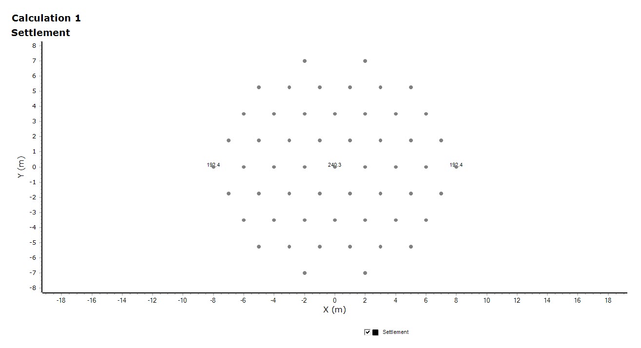

I am using the TContourPlot to show some data for which I have only 55 data points (data is inclued at the end of this post). On the plot below, I additionally draw small grey circles where my data points are located (i.e on a triangular pattern).

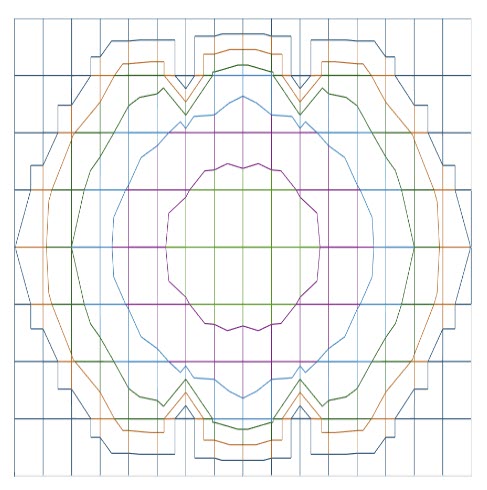

The plot I am expecting to get is as follows:
Expected contours.jpg (50.12 KiB) Viewed 4875 times
(I created this in Excel but had to interpolate between the data points, adding an extra point between every four circles)
However, I cannot get TChart to produce any contours for this data set.
Are there any settings within TChart that I can use to produce contours for this set?

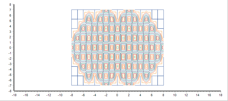

Re: How to plot contours for a sparse data set?
Post by Yeray » Thu Jun 12, 2025 12:49 pm
I've been playing with your data and I came up with this:
I'm not sure if that fits your requirements.
Note the PopulateMissingPoints method helps to make sure the data follows a regular grid structure so the TContourSeries can handle it.
Note there's also a TPointSeries with the raw data I used for testing.
