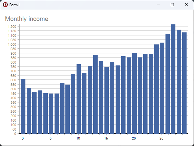

Have you tried with the main title? It seems to give the result you'd expect:
  with Chart1 do
    Title.Text.Text := 'Monthly income';
    Title.Font.Color := Axes.Left.LabelsFont.Color;
    Title.Font.Size := 15;
    Title.Alignment := taLeftJustify;
left title.png (11.93 KiB) Viewed 1002 times
