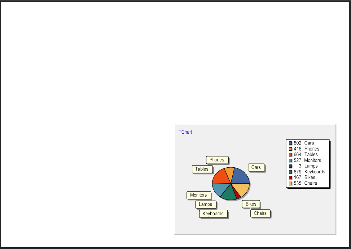

I've added a Pie to your sample project and I've set it to 2D.
This is how the pdf looks for me here:
