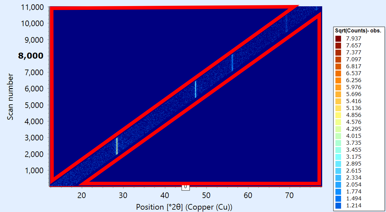

We have some performance problems drawing large TColorGridSeries of sparse matrices, see attached plot. Basically, there is only the small diagonal patch in the middle where there is data to plot:
IsoLinesPlotScreenshot 2025-07-10 150510.png (359.69 KiB) Viewed 15534 times
The area of the Red Triangles is empty and doesn’t contain any data. Is there a way to speed up handling and drawing by telling the plot that there are parts of the data that don’t need to be plotted?

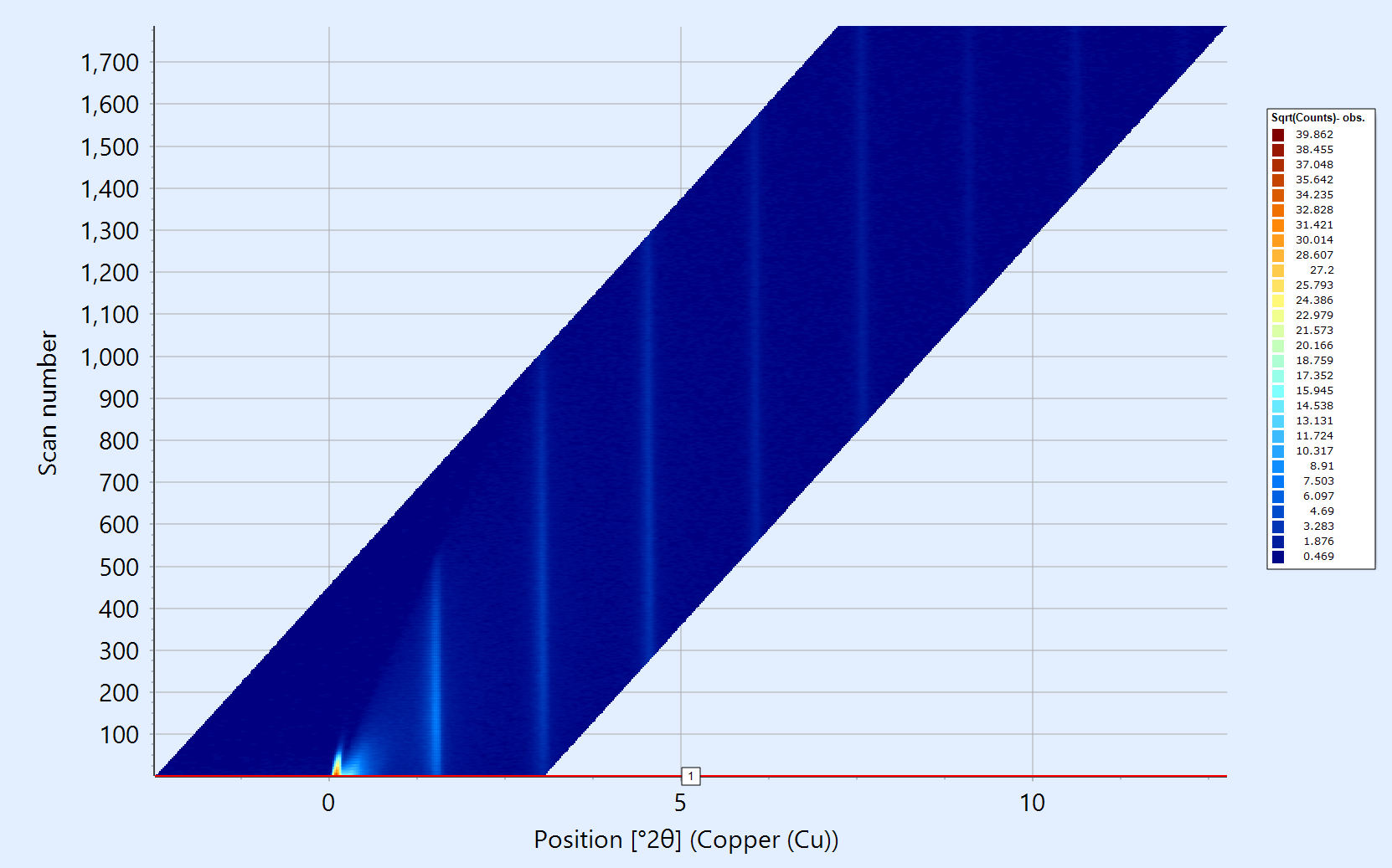

By Binning the Matrix down to about screen resolution I was able to improve the performance.
In addition I used Series.SetNull(Index) to hide areas.
Like this:
 if FIsoLines3D then
   var IndexSurface := ScanSurfaceSeries.AddXYZ(aX, ScanSurfaceSeries.DefaultNullValue, aZ);
   ScanSurfaceSeries.SetNull(IndexSurface);
 end else
   var IndexColorGrid := ScanColorGridSeries.AddXYZ(aX, ScanColorGridSeries.DefaultNullValue, aZ);
   ScanColorGridSeries.SetNull(IndexColorGrid);

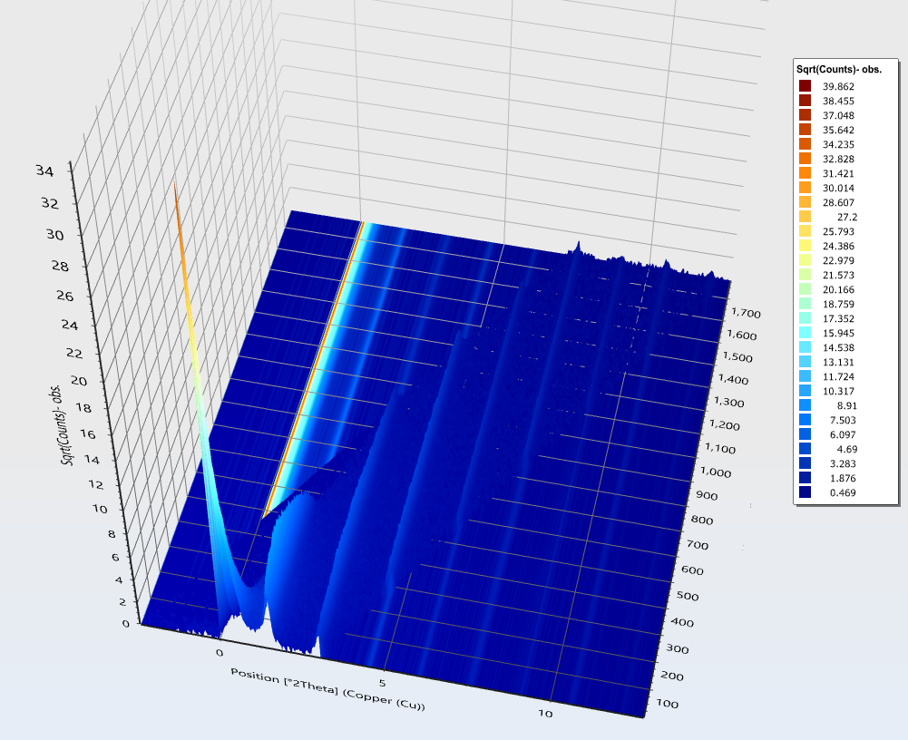

This works nicely for TColorGridSeries but it obviously doesn't work for SurfaceSeries!?
Please see Screen Shots.
