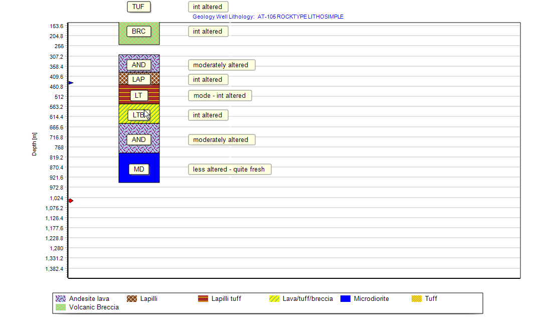

One more question about bar charts and marks. Is there an easy way (i.e. some chart command) to stop marks from displaying outside the graph axes when I zoom or pan (see attachment)?
Re: Stacked Bar Chart and Marks
Post by Yeray » Mon May 05, 2014 7:14 am
Hi Errol,
Errol wrote:Is there an easy way (i.e. some chart command) to stop marks from displaying outside the graph axes when I zoom or pan (see attachment)?
Yes, the Series' Marks.Clip property:
Series1.Marks.Clip:=true;
