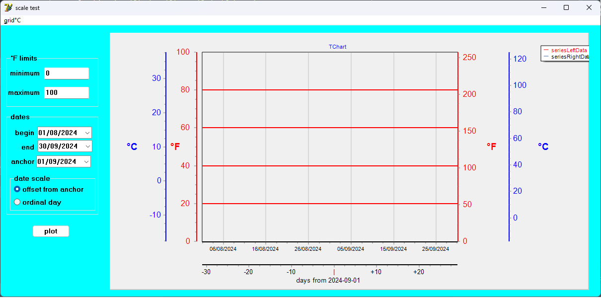

Here's yet another related issue. When I create a new axis to be an auxiliary scale on the right, it looks strange, because
  • As previously discussed, the title appears to the left of the scale, when it should be to the right. This will be fixable by using your new Distance parameter.
  • The ticks and labels are to the left of the axis, when they should be to the right. I don't think any existing user-accessible parameter controls this.
What might be good is to add a Side property to tChartAxis, with values [Left, Right, Top, Bottom]. Then when a user created a new axis with Side=Right, the axis's ticks & labels would automatically be on the right of the axis, and the default position of the axis title would be to the right of the labels. I wouldn't make such an axis have the PositionPercent behavior of RightAxis, but I suppose you might feel obligated to do that for a sort of consistency.
I'll put my latest demo code up on my site in the next few minutes.

Here is another related issue. Your new Distance parameter will allow the title of right-sided auxiliary axes to be moved to the right of those axes, but the ticks and labels of those new axes will still come out on the left. As my latest demo (at https://www.fenichel.net/programs/ScaleTest.zip) shows, that doesn't look right.
What might be good is a new tChartAxis.Side parameter, with values {Left, Right, Top, Bottom}. Then a new axis with Side=Right could automatically get its title, ticks, and labels all to the right of the axis, with the title's horizontal position still tunable with Distance.

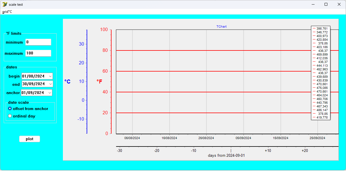

Re: scales and axes

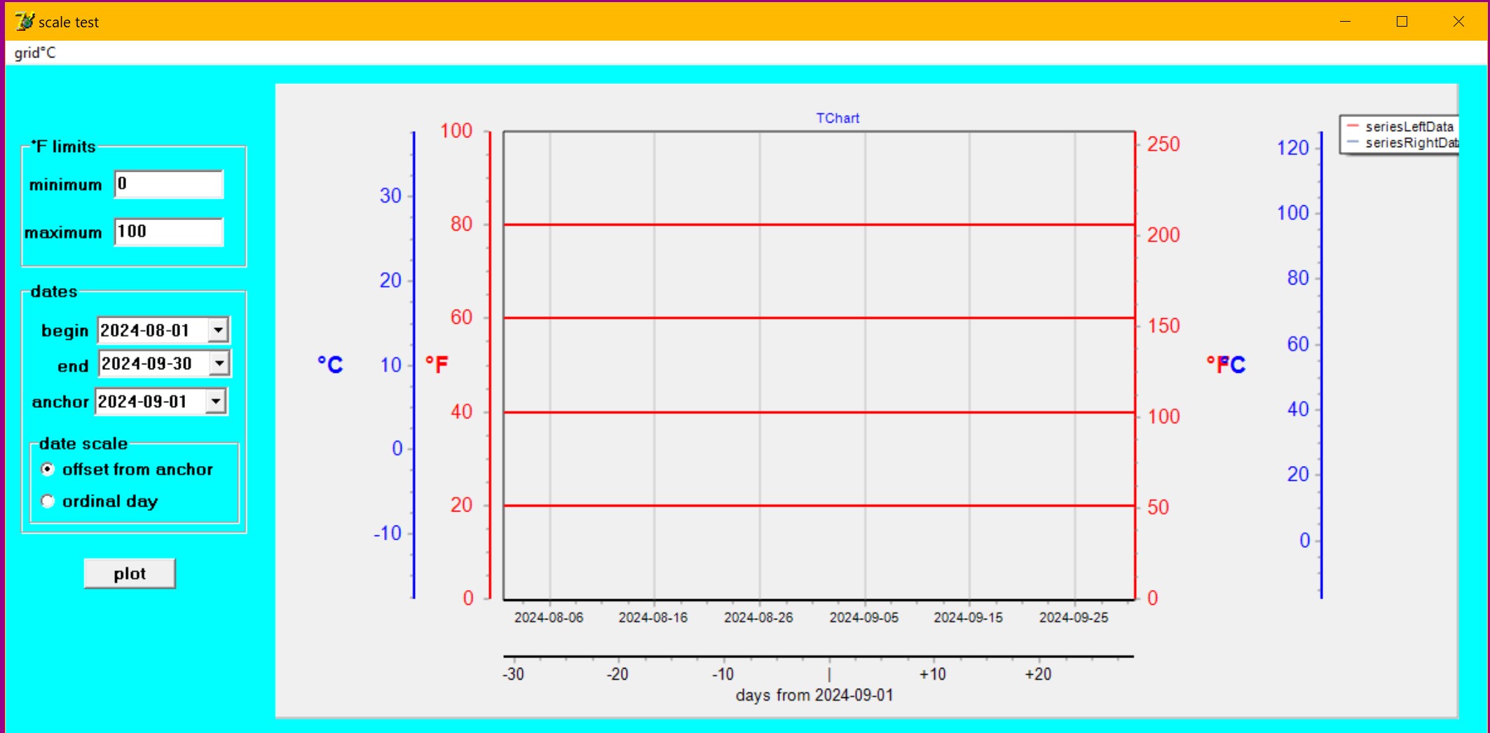

Post by Fenichel » Mon Sep 16, 2024 6:45 am
I think you are not looking at the latest version of my demo. When I run it I seeImage
But you're right; I hadn't noticed the OtherSide parameter. Should it be mentioned in the Axis chapter of the tutorial?

Post by Yeray » Mon Sep 16, 2024 9:58 am
Indeed I'm afraid I was looking at the wrong version of your project.
Adding a boolean property (ie OthSide) to your tScale and mapping it to the Axis OtherSice property seems to solve it for me here. Note I also had to modify your OuterPercent peorperty, which maps to PositionPercent:

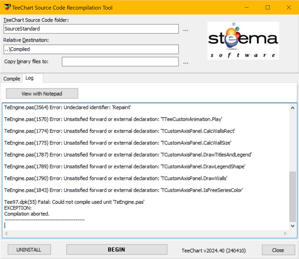

Are there instructions somewhere for TeeRecompile? I tried to run it naively, and I got various errors. I can post the error messages here, but maybe pointing me to some instructions would take less of your time.
Fenichel
Posts: 28
Joined: Fri Jul 19, 2024 12:00 am
Re: scales and axes
Post by Fenichel » Thu Sep 19, 2024 8:43 pm
Here is a screenshot of errors from TeeRecompile:
TeeRecompile failure.jpg (199.43 KiB) Viewed 291781 times

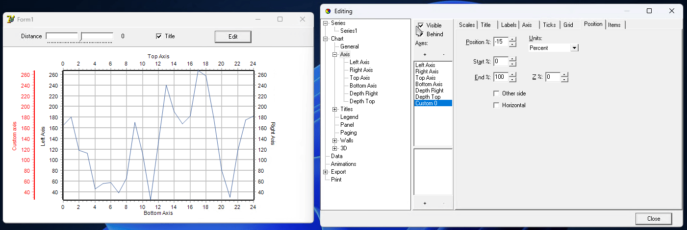

Re: scales and axes
Post by Yeray » Fri Sep 20, 2024 7:09 am
According to the error message (Tee97.dpk), you seem to be compiling TeeChart Standard v2024.40 for Delphi 7.
I've just tried it here and worked fine:
Have you modified those sources to add the new Distance property? Make sure the changes are correct.

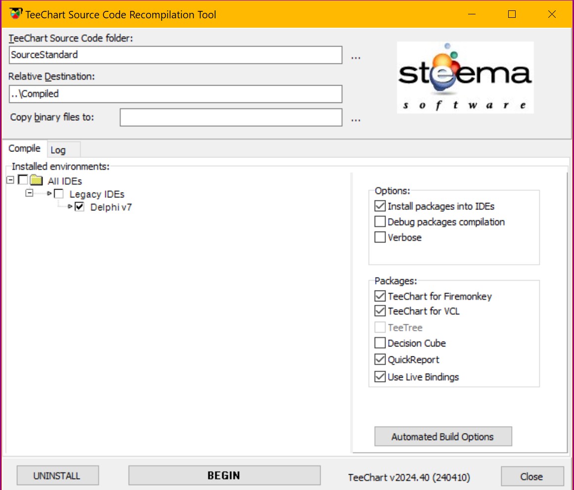

I can't tell what the problem is.
  • I can successfully run TeeRecompile with TeEngine.pas unmodified.
  • As carefully as I could, I re-edited TeEngine.pas to incorporate the changes you list in your post, and I get the same error messages.
  • That Repaint is undeclared is especially weird, since that is such a core Controls method.
  • Could I be checking the wrong boxes when I run TeeRecompile? Before I click Begin it looks likeImage
Could you put a copy of the correctly-edited TeEngine.pas somewhere for me to download?

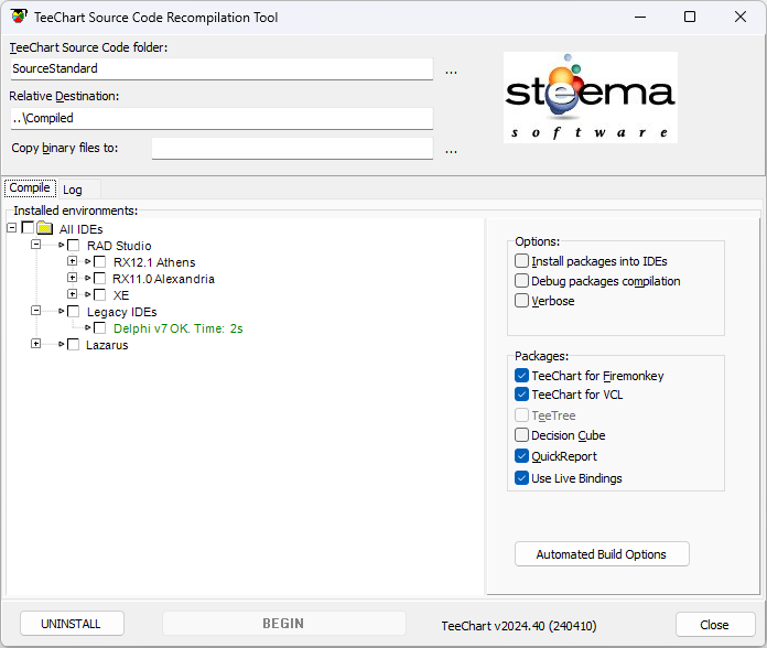

TeeRecompile now works for me. I must have been making some stupid transcription error in editing TeEngine.pas.

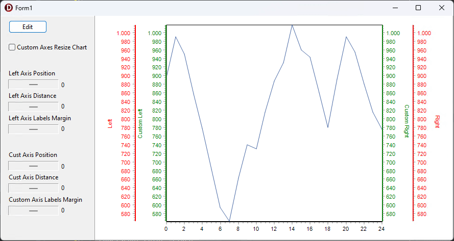

Distance works imperfectly for me.
  • It does fine with LeftAxis and RightAxis.
  • I haven't tried it on the top or bottom axes.
  • It seems to be ignored by auxiliary axes (my tScales).
As usual, my demo code is on my Web site at https://www.fenichel.net/programs/ScaleTest.zip.
Re: scales and axes
Post by Yeray » Mon Sep 23, 2024 9:23 am
Manually created axes do have their ResizeChart property set to false by default.
However, setting it to true will cause other side effects.
I'll investigate if there's anything else we can do.

Re: scales and axes
Post by Yeray » Mon Sep 23, 2024 10:51 am
After setting ResizeChart property to true for a custom axis, you can play with the Texts.MarginToAxis as well as the already mentioned Title.Distance and PostionPercent properties to adjust them as you wish:
