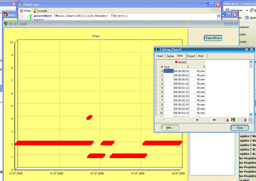

If I add DateTime Values to the bottom axis an open a Charteditor at runtime, the x values are shown correctly but the y values show the DatTime FormatString ('hh:mm') instead of the correct data. y data points are simple integer values.
See attachment.
Any suggestion about that behavior?

Messie

Post by Yeray » Wed Aug 26, 2009 3:20 pm
Hi Messie,
I see in your project that you've changed you series' ValueFormat from #,##0.### to hh:mm at design time. Note that this is for the YValues, so here it is the explanation of your result.
If you still find problems with anything, don't hesitate to let us know.

Post by Messie » Thu Aug 27, 2009 7:01 am
Yes, you're right. I thought that this was the correct position to set. So where can I set the format string for the DateTime X Axis?
Thanks, Ulfert

Hi Messie,
To show hours:minutes in the bottom axis you should do as follows:
  Series1.XValues.DateTime := true;
  Chart1.Axes.Bottom.DateTimeFormat := 'hh:mm';
Note that this is explained at the Tutorial 4 - Axis Control. You'll find tutorials and demos at TeeChart programs group.
