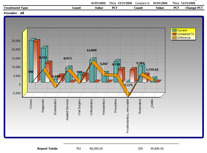

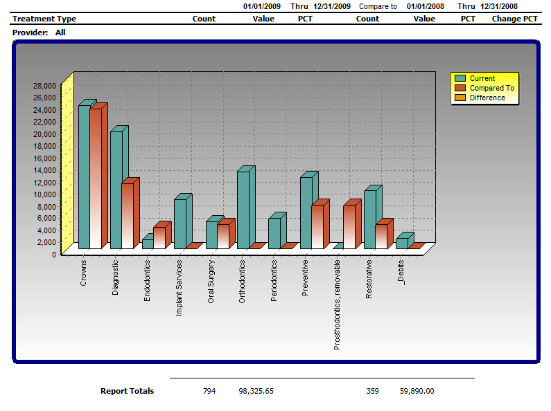

I discovered another problem with TChart on Report builder Report. The Differnce TLineSeries is not showing with D2010 but works fined with D2007. There were no changes made and used the same data.
The difference is a Function Subtract and uses Current and Compared To. I double checked the settings of the chart from D2007 and D2010 and they are the same except for a the new properties
See attached images. Are you aware of any issues like this one with the current Build?

Not that I can think of. Could you please try reproducing this with a TChart component, without using Report Builder? If the problem persists please attach a simple example project we can run "as-is" to reproduce the problem here. Otherwise please contact Digital Metaphors support, they are the manufacturers of Report Builder and its TeeChart wrapper.

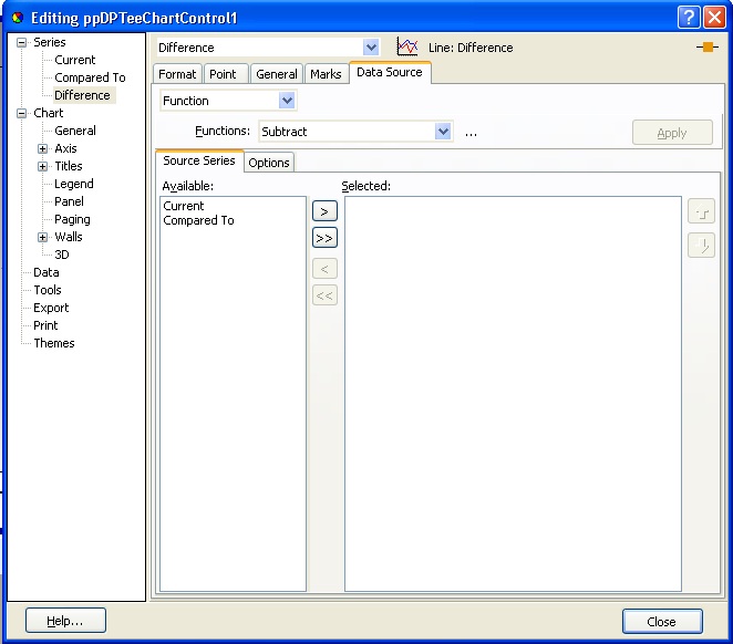

Please see attached Image.
I noticed that the Source Series does not save and stay as Available even though I moved them to selected.
The following code at run time solves the problem but I should not have to do that
ppDPTeeChart1.Chart.Series[ppDPTeeChart1.Chart.SeriesCount-1].DataSources.add(ppDPTeeChart1.Chart.Series[0]);
ppDPTeeChart1.Chart.Series[ppDPTeeChart1.Chart.SeriesCount-1].DataSources.add(ppDPTeeChart1.Chart.Series[1]);
if you still think is Report builder issue. I will contact them but usually i get bounced back and forth when two vendors are involved

We will be glad to look at the issue here but could you please attach a simple TChart example project with which we can reproduce the problem and let us know the exact steps we should follow to reproduce it?

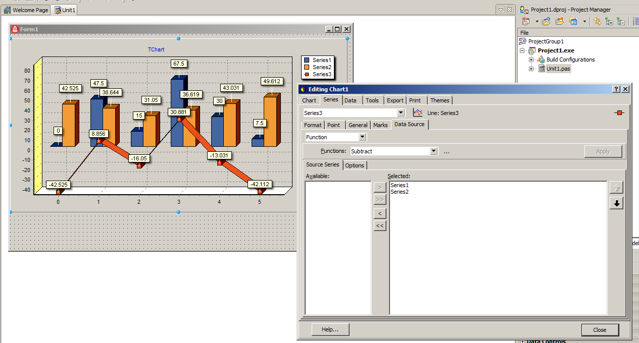

Attached is a sample project. The linesSeries (series3) with the subtract function is visible at design time but not at runtime.
Delphi 2010 and Teechart 8.06
Thank you
Thank you

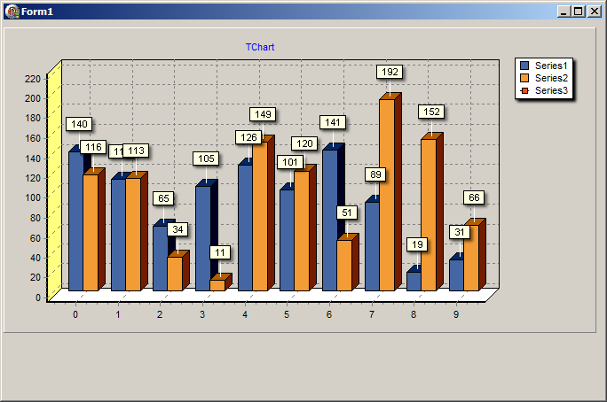

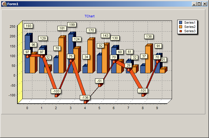

I opened your project with D2010 + TeeChart 8.06 and saw the following at design time: The I executed and got the following result: The problem is that in the FormShow method you populate your bar series but you don't check that data with your Series3. So adding the following line at the end of your Show method:
I obtain the following result:
Series3.CheckDataSource;
