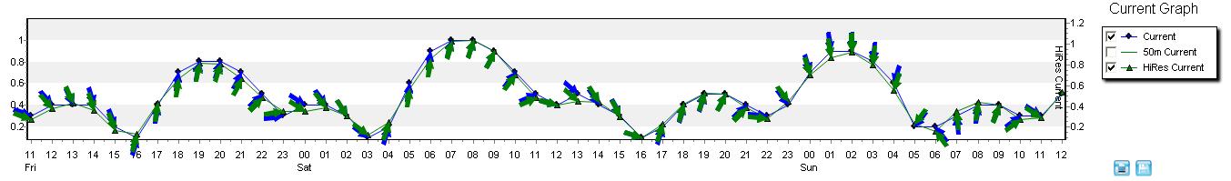

Thanks for the prompt reply and suggestions. I am still investigating the best way to display the arrows on the chart and would love to hear your recommendation. My application needs to plot wind speed and direction. I have an existing line series that plots the wind speed but I would like to draw arrows indicating direction (0-360deg) at each of the speed series points. I would like to be able to change the colour of each arrow if required also.
I have attempted the following but each have there pros and cons, in particular because I may be drawing 2 wind speeds and directions. I find some methods require an after draw event and am conscious about it being called on most over mouse events etc:
- Using ArrowSeries
- Using ImagePointSeries and loading bmps of arrows
- Drawing directly onto the canvas using Arrow( fill, Percentage, From, To, W, H...)
I have attached a screenshot of my app showing current speed and direction for reference. Although this does fulfull my requirements I would like to ensure i am using the best method.
A separate question (may be dumb), because I am drawing on the canvas is there an easy method of checking for overlap with the axes (as can be seen in the screenshot) or is it up to me to manage the drawing space.
Any help is greatly appreciated,
D'Arcy

Re: ArrowSeries->Add versus ArrowSeries->AddArrow
Hi D'Arcy,
With ImagePointSeries I suppose the problem is that you have to assign a different image for each color and rotate the image everytime.
If the ArrowSeries doesn't offer a good solution for you, I'm afraid that I'd bet for the custom drawing, as you've already done if I'm not wrong.
If you still find troubles with it, please, don't hesitate to let us know.
The simplest to use would probably be the ArrowSeries. Could you please tell us what contras have you found with that solution? If we can't tell you a way to solve the problems you found, it could give us ideas for a future version.darcy wrote:I have attempted the following but each have there pros and cons, in particular because I may be drawing 2 wind speeds and directions. I find some methods require an after draw event and am conscious about it being called on most over mouse events etc:
You could check if the arrow you are going to draw has any point out of the rectangle Chart1.ChartRect. You'll probably have to use windows' PtInRect(TRect,TPoint)darcy wrote:A separate question (may be dumb), because I am drawing on the canvas is there an easy method of checking for overlap with the axes (as can be seen in the screenshot) or is it up to me to manage the drawing space.
