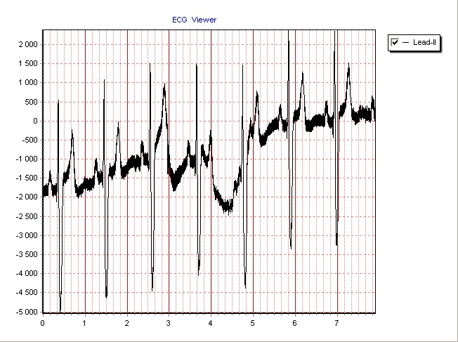

I have a plot of a time series like this :

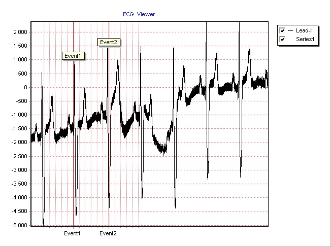

I want want to a add some events to this plot. So I create a pointseries ser1 and I added two points with labels to it:
ser1->AddXY(1.4,1000,"Event1");
ser1->AddXY(2.6,1500,"Event2");
I got this image :
Why the numerical values on the X axis labels are replaced with the labels of the second series ?
Can I add the pointseries with labels (to show them inside markers) without displying the labels on the X axis ?
Best regards,
Yazou
Re: Points labels are displayed on the X axis?
Post by Yeray » Thu Jan 28, 2010 10:24 am
Hi Yazou,
I think that you are looking for this:
Chart1.Axes.Bottom.LabelStyle:=talValue;
