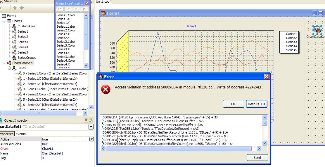

Hello and thanks for the quick reply. Try to do this at design time:
1. add new TFastLineSeries in Chart1
2. update the fields of ChartDataSet1 (delete all + add all fields)
3. set Chartdataset->Active = true -------> error
I've attached a screenshot
Greetings!
Re: TChartDataSet Problem
Post by Narcís » Mon Feb 08, 2010 11:42 am
Hi realtracksystems,
Thanks for the information. I could reproduce the issue here and added it to the defect list to be fixed (TV52014671). I also checked that this works fine for me here using TeeChart Pro v2010 Beta. You may also want to check if this works at your end.
