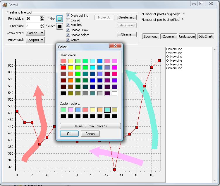

I want to add custom colors to the color dialog , which appears when TColorButton is clicked. Is there any possibility to add a 'custom color string' to the TeeChart application?

>Do you have a list of colors you want to be shown in the below part of the series' color picker window?
-Yes. Please see image attached. The code above was used with TC v7.12
odissey1
odissey1
- TButtonColor dialog with pre-defined custom colors
- PenDraw_05.jpg (89.87 KiB) Viewed 19055 times

Re: Add Custom Colors to TColorButton color dialog
I have no problem adding colors to the standard TColorDialog. The one you see on the picture is an internal TColorDialog from TButtonColor, which is a TeeChart component (lime color button on top of the form). The problem is that this color dialog is not public neither published, so there is no regular access to it. The fix I posted above gives access to TCustomColorString inside TeCanvas unit, but this is not nice way to do it. I hope that Steema can change this internal TColorDialog to published, so it could be edited at design time.
Hi odissey1,
Ok, I think now I understand your situation. And yes, for some situations your request could be useful. I've added it to the wish list to be implemented in future releases (TV52014664).
In the meanwhile you could use TButtons (with a TEdit without text, but color) with the standard TColorDialog. Something as follows:
