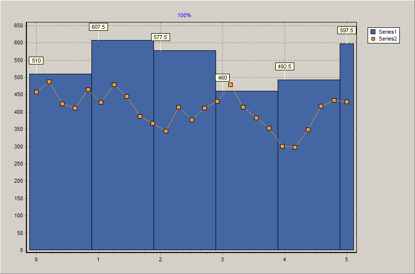

I've seen that having a Bar Series and a Line Series with different number of values, the last bar is shown thinner that the others if you set BarWidthPercent to 100. So I've added it to the defect list to be fixed in future releases (TV52014752).
uses series;
var bar1: TBarSeries;
    line1: TLineSeries;
  Chart1.View3D:=false;
  bar1:=Chart1.AddSeries(TBarSeries.Create(self)) as TBarSeries;
  line1:=Chart1.AddSeries(TLineSeries.Create(self)) as TLineSeries;
  bar1.FillSampleValues();  //6 points
  line1.FillSampleValues(); //25 points
  line1.Pointer.Visible:=true;
  bar1.BarWidthPercent:=100;
