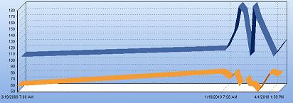

I have a graph of 2 series with the bottom axis as date time. I have the bottom axis as date time format as 'mm/dd hh:mm' with multi line labels set to true. The labels still display on one line. Also, I would like to show all dates one after the other without any big gaps in the graph. For instance, if the first graph date is 3/2009 and the next dates start in 2010 all the latter dates are bunched together at the right side of the graph with a large gap between the dates. I have the bottom axis set to automatic. I have attached a picture of my problem. I have tried to follow the tutorial on Axes but I can't seem to solve these problems. Can you please tell me what simple change I have to make to fix this. Thanks.

You may need to add a line break in the labels format, for example: 'mm/dd' + #13 + 'hh:mm'

This could be related to the labels style you set for the bottom axis. Try using different LabelStyle available. You can also try changing Increment.Also, I would like to show all dates one after the other without any big gaps in the graph. For instance, if the first graph date is 3/2009 and the next dates start in 2010 all the latter dates are bunched together at the right side of the graph with a large gap between the dates. I have the bottom axis set to automatic. I have attached a picture of my problem. I have tried to follow the tutorial on Axes but I can't seem to solve these problems. Can you please tell me what simple change I have to make to fix this

The #13 did the trick on the labels. Attached is a project with the gap problem. I am using Delphi 2007 with Tee Chart 8.04.11395. Thanks.

First of all, note that datetimes are, in fact, doubles. In your example, between your first and second points, there are 10 months of distance while, between the second point and the last, there are only 3 months of distance. So, I think it is logical that, in a continuous bottom axis with a regular increment, the axis should reflect this difference in distances.
If you want, for example, to have always the same distance between two consecutive points, you could add the points without XValue (so teechart will give integers to them 0, 1, 2, 3,...) and add the YValue and the label as you are doing.
