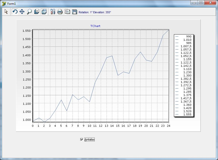

Post by Yeray » Wed Jun 09, 2010 8:36 am
Hi johnnix,
As said here, I'll try to explain the status of this problem (TV52014825).
We've made some tests more that show more (yes, even more) strange results, but we aren't sure about the cause of them.
As said before, we've found that this only occurs with older Delphi versions up to Delphi 2006. With Delphi 2007 and above works fine, so it could be a bug in old Delphis.
In addition to this, the problem seems to be in the combination of TAntiAliasCanvas (used in TAntialiasTool) with some perspective of the grid lines. We observed that rotating the chart the grid lines change from smalldots to solid lines and vice-versa:
