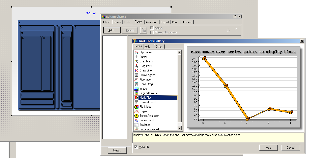

The MarksTip tool can be found, through the editor at the Tools Tab, Series section. Here you have a picture:
