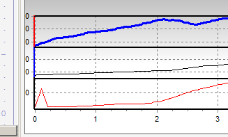

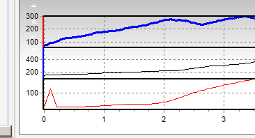

My problem is not solved. I will attach a couple of images to explain my problem. At first (image before_click) , when the chart appears the vertical axis texts almost doesn't appear.
If I click on the chart (image after_click) the texts appear more, overlapped but they appears.
What can be the problem ?
I am looking for the answer and I can't find the solution.
thanks in advance

Post by Yeray » Wed Nov 24, 2010 3:53 pm
Hi soulianis,
Clicking on the chart changes it? Are you using OnClick event to change something on it?
If not, it could be a chart repaint more than a click. If so, you could try forcing the chart to be redrawn when the initialization finishes. Try the call:
Chart1->Draw();
You could also try adding some margin to the left side of your chart:
Chart1->MarginLeft = 10;
I hope it helps!
