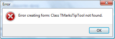

I get the following error when I start Delphi now...

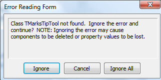

When I hit Cancel - I then get
This all started after I add the MarkTips tool to the TreeMap Series. I am about to uninstall and then reinstall the TeeChart Components...

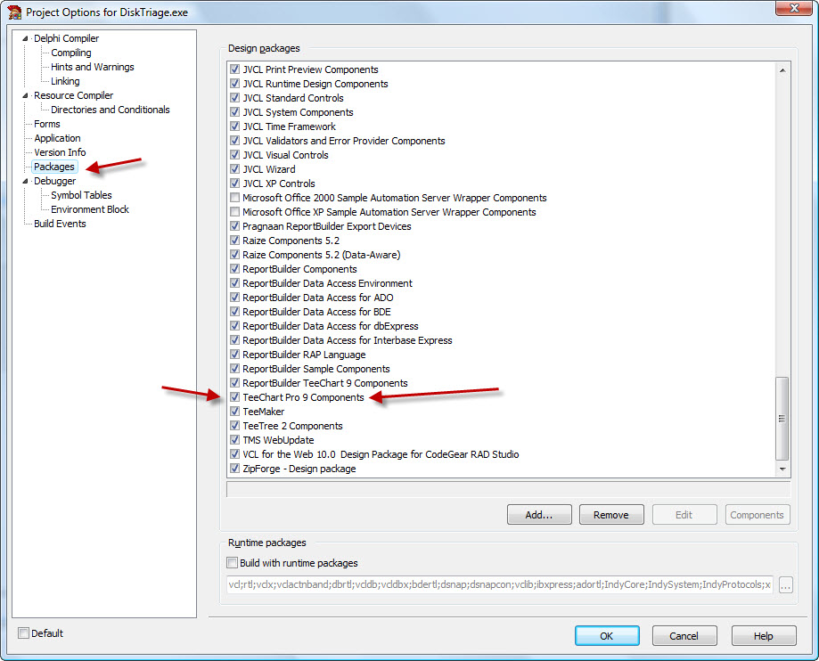

1. Go to Project -> Options -> Delphi -> Packages and check that TeeChart Pro 9 Components (v2010) package from source code compilation path is enabled.

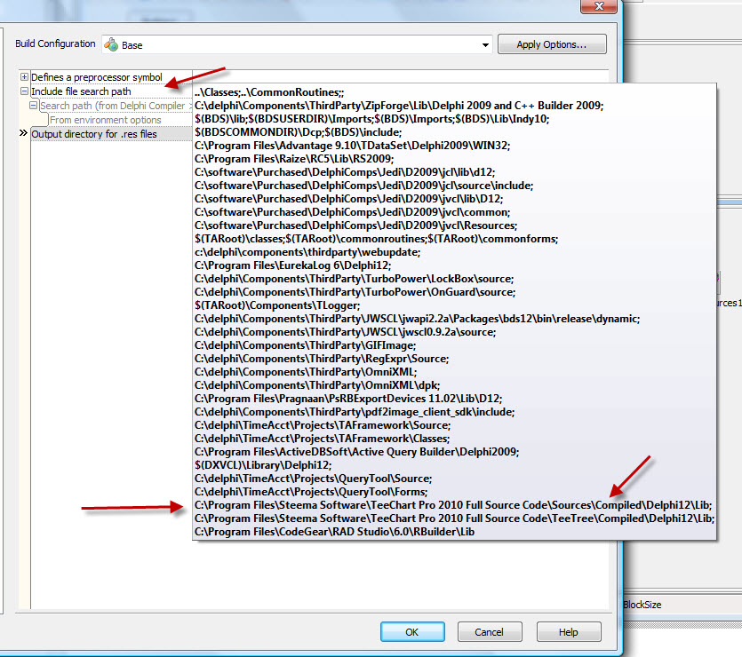

2. Go to Project -> Options -> Delphi -> Resource Compiler -> Directories and Conditionals -> Include file search path and check that if any TeeChart path is in this list it belongs to the source code folders created from TeeRecompile and they are on top of the list. Otherwise remove them.

Ok - I did the checks you recommended (see screen shots) - and it all looks fine - from what I can see

1. I start Delphi - and open the project - I get the message
2. I close the project - and then reopen it - NO Message is shown.
3. I close and restart Delphi - and the first time I open the Project - I get the error message again. However, after that the message does not appear.
