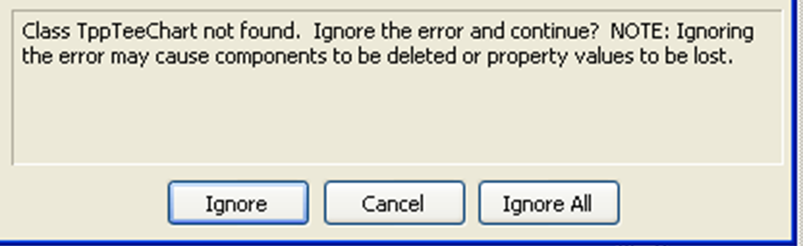

I have a project that was developed with a previous version of TeeChart. This error appears
Teechart error.png (220.05 KiB) Viewed 2964 times
I have checked that on the project options I have the TeeChart Pro 9 components activated ( BTW is this the only one that has to be there?)
and I have checked that the file search has the ...\TeeChart \lib path on top...
what else am I missing?

TppTeeChart is the ReportBuilder wrapper for TeeChart. Do you have the ReportBuilder packages supporting your TeeChart version installed? As far as I know both ReportBuilder 11 and 12 support TeeChart v2010 VCL.

I do... and it is an active package also... I'll contact them to find a fix for this issue... It might have to do with the order I installed the components
Thanks a lot for your help.
Re: Startup Error
Post by Narcís » Fri Jun 04, 2010 3:28 pm
Yes, this could be the cause. You should install ReportBuilder after TeeChart.
