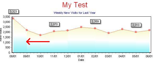

I have an area chart and am trying to apply a gradient. I am noticing the gradients are drawn for each bar independent of one another. This does not result in a very smooth transition between bars (note especially the first bar). Is there a way to apply the gradient so that it is consistent across all bars?

I'm afraid this is not possible for now. TBarSeries already has GradientRelative property. I have added your request to the wish-list (TV52014958) to be considered for inclusion in future releases. In the meantime you could use a TBarSeries setting BarWidthPercent to 100 and GradientRelative to True.
