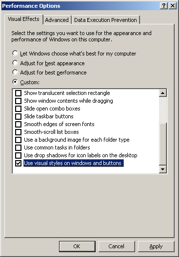

We've seen that on Windows 7, if you activate "Use visual styles on windows and buttons", the problem isn't reproducible:
But this option doesn't seem to have the same effect regarding this issue neither on Windows Vista or XP.
We've also seen that forcing a repaint after calling TeeCreateBitmap with Chart1.Draw, the problem disappears.
Could you please confirm this?

1) Setting the WINDOWS visual effects option has no effect on our XP development computer
