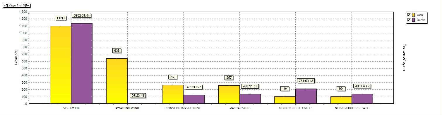

On the chart we can see that the BarSeries are orderd by the yellow color.
Is there is a quickly method to order it by the purple color?
Thanks for help

no this is not what i want.
In the case the yellow bar graph is in descendant order.
I would like in an other case to order the purple bar in descendant order by calling one function.
Of course i am able to recalculate all the point values in order to do that but perhaps you have it in your methods.

If you want to Order a Series by the YValues ValueList, you can do it by:
  Chart1[1].YValues.Order:=loDescending;
  Chart1[1].CheckOrder;
