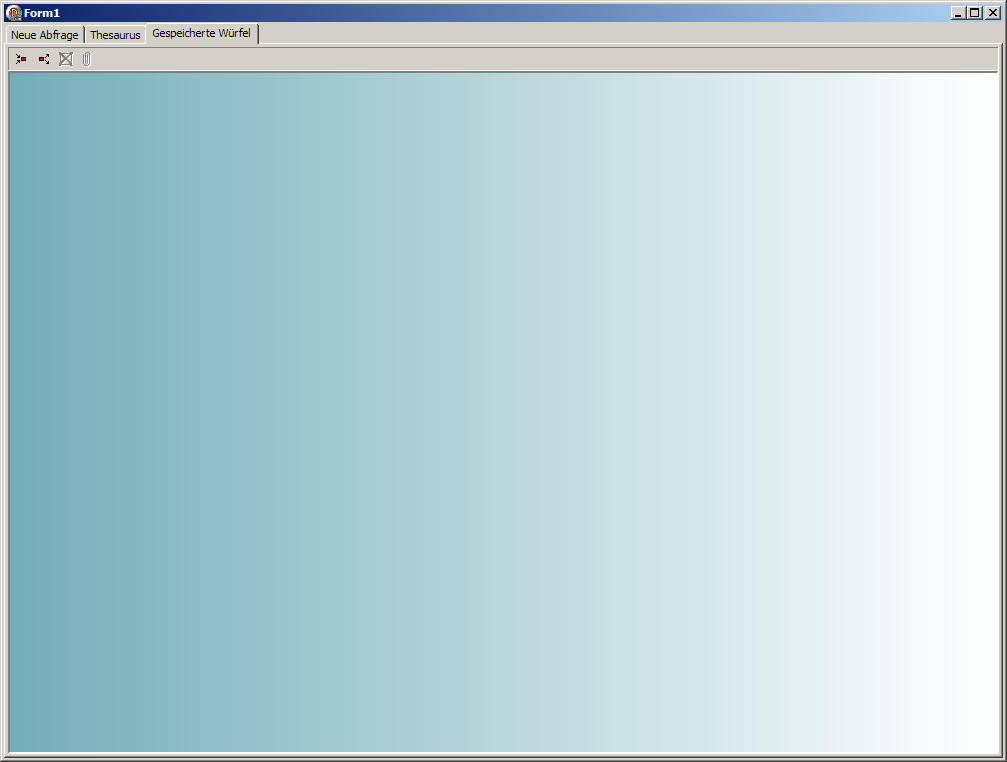

Your project is using some components I don't have here so when I opened it, prompted me a message telling me that TXDBGrid class hasn't been found. After ignoring the error and trying to compile, I had to remove some declarations and the unit XDBGrids from the uses list.
Then I could compile and run the application. I've one to 'Gespeicherte Würfel' tab and I see the following, where doesn't seem to be anything I can remove. And pressing "Del" does nothing.

Please click on the blue part of the form (this is a dbtree with gradient) and try to delete it.
