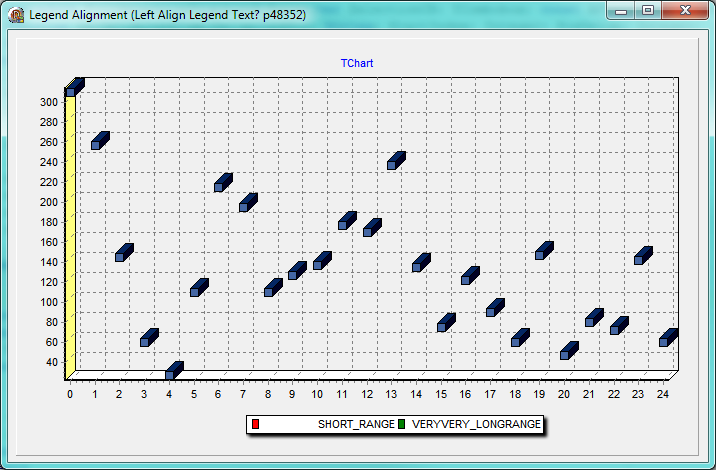

erzsebet
Posts: 21
Joined: Tue Apr 13, 2010 12:00 am
Re: Left Align Legend Text?
Post by erzsebet » Fri Jul 30, 2010 3:48 pm
Narcís, hello -
Thanks for answering my question about the attachment! I don't know how I missed the "Upload Attachment" tab! I will blame the fact that it is Friday!
In any event, this image shows the issue I am having with the legend:
Shows space between text and symbol.
I would like the "BORCHERS-BORCHERS, S." text to appear right next to the blue square, not far away like it is. I understand that the spacing is determined by the fact that "MANCHO PRADO-MANCHO PRADO" is longer than the "BORCHERS-BORCHERS, S" text, but is there some way to get manipulate the legend into displaying the text left aligned within the space allotted to each item?

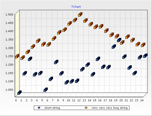

Post by Yeray » Fri Jul 30, 2010 4:51 pm
Hi erzsebet ,
What TeeChart version are you using?
I'm trying the following code with the latest sources and I can't reproduce the issue:
uses series;
  Chart1.Legend.Alignment:=laBottom;
  with Chart1.AddSeries(TPointSeries) do
    FillSampleValues();
    Title:='short string';
    FillSampleValues();
    Title:='very very very long string';
Could you please try the code above and see if you can see the same than me or not?
If you can't reproduce the problem with it, could you please try to modify it so we can reproduce the problem here?
erzsebet
Posts: 21
Post by erzsebet » Thu Aug 05, 2010 9:54 pm
Yeray and Narcís, hello!
I hope you are both having a good day! Thanks so much for the time you've already put in to help me on this issue. Here is some more information.
I am using TeeChart Pro 8.06 with Delphi 2010. My issue with legend text alignment seems to be caused by overriding events to custom draw a customized legend. I have recreated the problem in the attached code. Please let me know if you have any suggestions on how I can get the legend text to appear closer to its associated symbol.
-erzsebet
Post by Yeray » Fri Aug 06, 2010 2:18 pm
Hi erzsebet,
The Legend.TextStyle by default shows the values and the labels if present, and it alignes the "text" to the right. If you set the TextStyle to be Plain, like you would do if you would like to show the labels, the text is aligned to the left:
Chart1.Legend.TextStyle:=ltsPlain;
erzsebet
Posts: 21
Post by erzsebet » Fri Aug 06, 2010 2:53 pm
Thank you, Yeray!! That was exactly what I needed to do to fix my legend text alignment problem! You and your entire team are awesome!
