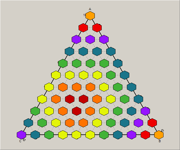

KevinKillion wrote:* colors assigned differently if "ProcessMessages" is used between adding points
I can't see any difference. I've tried simplifying your example to the following but I can see the same in the two pictures exported:
uses TeEngine, Chart, TeeSurfa, TeeTernary, TeExport, TeePNG;
var Chart1: TChart;
    Series1: TTernarySeries;
    i: Integer;
    a, b, c, distance: longint;
  Chart1:=TChart.Create(self);
  Chart1.Parent:=self;
  Chart1.Height:=500;
  Chart1.Width:=600;
  Chart1.Legend.Visible:=false;
  Chart1.View3D:=false;
  Series1:=TTernarySeries.Create(self);
  Chart1.AddSeries(Series1);
  for i:= 0 to 1 do
    with Series1 do
      Clear;
      for a := 0 to 10 do
        for b := 0 to (10 - a) do
            c := 10 - a - b;
            distance := ABS(a - 3) + ABS(b - 3) + ABS(c - 5);
            AddBubbleXYZWeight(a * 10, b * 10, c * 10, 15, distance);
            if (i=1) then
              Application.ProcessMessages;
      TernaryStyle:=tsBubble;
      UseColorRange:=False;
      UsePalette:=True;
      PaletteStyle:=psRainbow;
      Pointer.Style:=psHexagon;
    if i=1 then
      TeeSaveToPNG(Chart1,'C:\tmp\Chart1Msg.png')
      TeeSaveToPNG(Chart1,'C:\tmp\Chart1.png');
