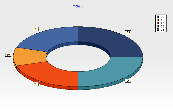

I'm not sure to reproduce it. I'm running the following code in the latest published version and in the actual sources and I'm getting the same result.
uses TeeDonut;
var Series1: TDonutSeries;
  Series1:=Chart1.AddSeries(TDonutSeries) as TDonutSeries;
  Series1.Add(20);
  Series1.Add(10);
  Series1.Add(20);
  Series1.Add(25);
  Series1.Add(25);
  Series1.Shadow.Visible:=false;
  Series1.RotationAngle:=90;
Could you please try to modify the code above so we can see the difference here? Or, please, arrange a simple example project where we can see it.
