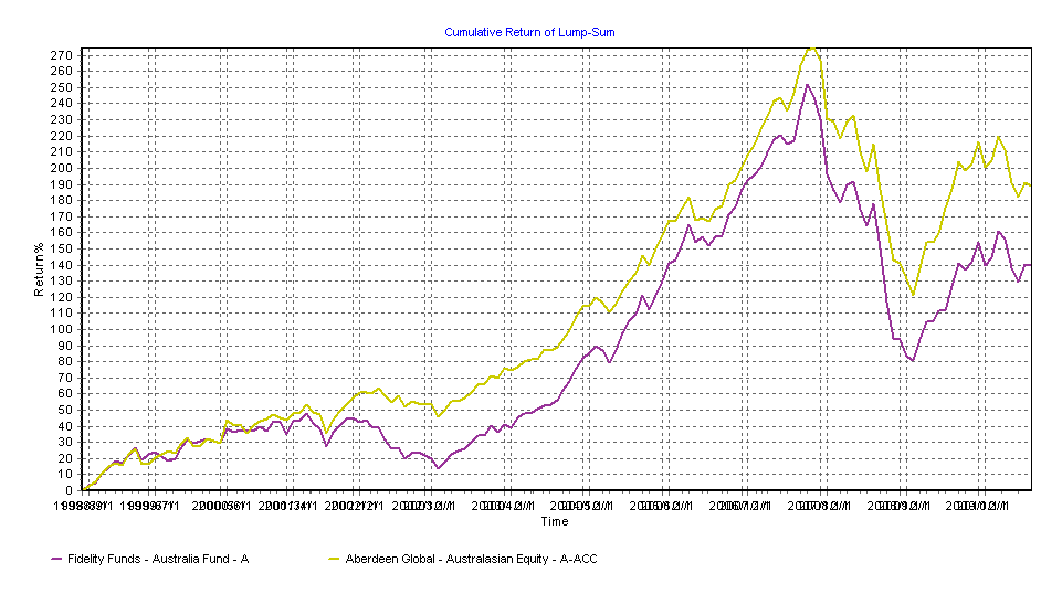

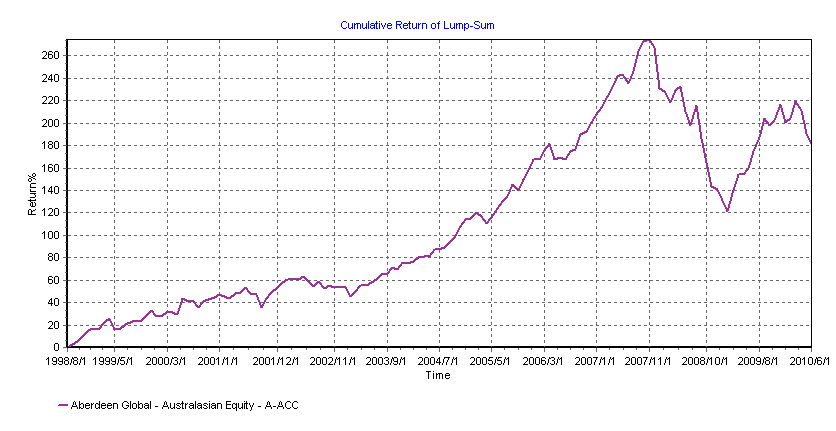

After install Teechart v2010.01 Prelease, the bottom axis of teechar become very strange.
the bottom axis's label is overloped.
as attached file
Teechart 7.gif:original chart
Teechart v2010.01 VCL non-stable prelease.gif: after install Teechart v2010.01 Prelease.
as attached file

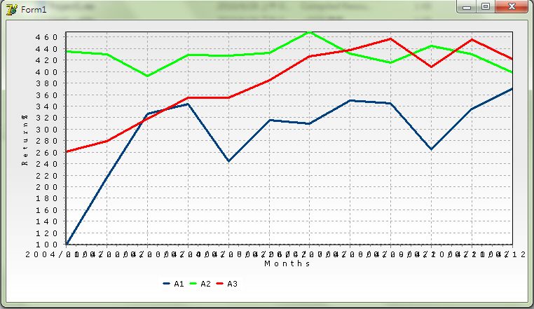

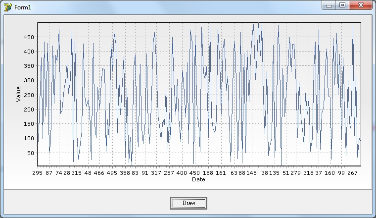

Hi:
Teechart VCL v2001.01 is really unstable.
Lables of bottom axis overlaps.
Image and sample program is attached.
When will stable maintance release launch?
Daniel
Daniel

Re: Strange Bottom Axis
Hello Daniel,
I suggest you change labels alignment of your bottom axis, so it are not overlapping. You can use next line of code for change it:
I have checked it with last version TeeChart VCL and works for me.
Chart1.Axes.Bottom.LabelsAngle:=90;

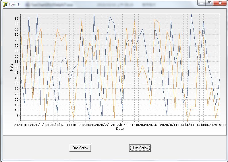

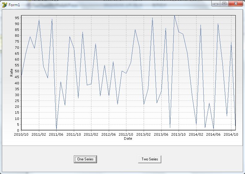

Hi:
I have upgraded to the latest version of TeeChart VCL.
TeeChar Version:October 05, 2010 Build 2010.01.11004
Delphi 7
Window 7 64 bit.
I have atached a sample program.
If you click one series the chart works fine.
if you click two series you can see the label of bottom axis overlape.
Daniel
Delphi 7
Window 7 64 bit.
Daniel
Hi Daniel,
It looks to be the same. I've seen that it works in v2010.00 and overlaps in v2010.01. I've incremented the ticket priority (TV52015179).
Hi Daniel,
After investigating the issue in Draw.zip further we came to the conclusion that this is not a bug. We found that in your project you had set bottom axis LabelsSeparation property to zero, thus no label anti-overlap calculation is performed. Setting LabelsSeparation to default value (10%) works fine:
Chart3.Axes.Bottom.LabelsSeparation:=10;
