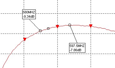

Here's a sample of a soft that really does exactly what I want :
The Marks are individually painted on the chart when the series point is clicked.
... and no, I don't have the source code of this soft :(
(... but I'm sure it uses TeeChart component !)
I've tried to use the series.marks.items.add method but failed because of lack of understanding the 'pointer' parameter...
By clicking on series points, I get their valueindex, but I don't know what to do with them to display the related marks (and only them !)
Laurent
