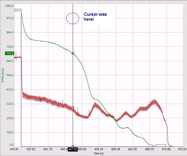

I think we misunderstand each other.
As seen on the enclosed screen shot (from a measurement program I'm about to "copy") I want to get the YValue that is on the same horizontal position as the cursor, but not necessarily on the same vertical position.
You wrote:
>>You can also obtain the pixel for a determinate series' value, knowing it's index in the series:
>>XPixel:=Chart1[0].CalcXPos(10);
My question is now:
How can I obtain the Index of the YValue in the series?
Do you get it?

Re: How to get YValue according to horiz. position of cursor?
Thanks for that, but I don't want/need to interpolate the value between the points, just get the value closest to the cursor.
I'm pretty sure it is just a very simple line of code that I need to retrieve that index as described above, but which code?
I don't think that's the function I need, and it sounds like overkill to use a separate Tool in my case.
I'm actually still pretty sure that I'm just missing one line of code.
As discussed above:
My question is still:
Maybe something like:
YValueIndex := Chart1[0].CalcYValueIndex(CursorsXPositionInPixel);
Then I could use this YValueIndex to finally get my value:
Result := Chart1[0].YValue[YValueIndex];
