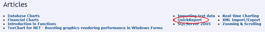

Re: How to use original and TChart 2010 parallel?
Post by Yeray » Mon Feb 14, 2011 8:50 am
Hi achristouio,
The articles page is blank until you select the article to see from the menu:
http://www.teechart.net/reference/articles/index.php
