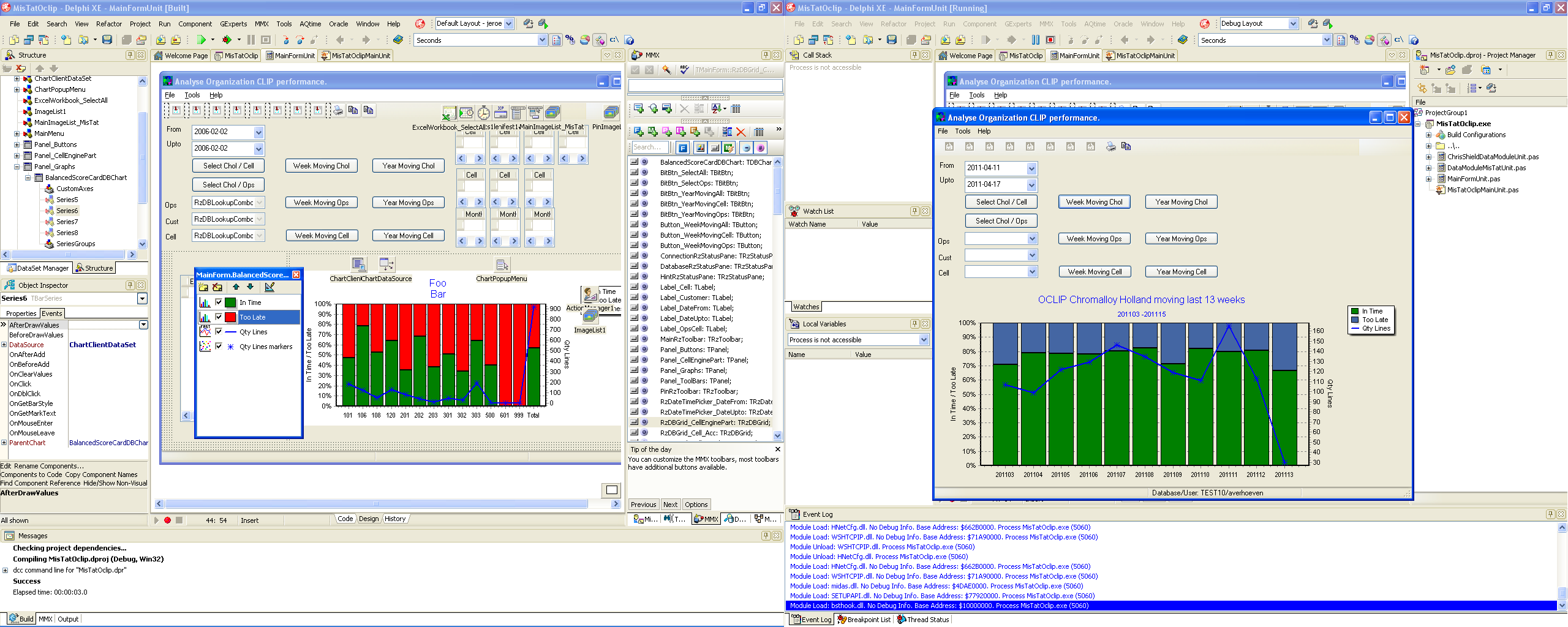

We have an issue with TeeChart where in Delphi XE the color of one particular series is not correct, but in Delphi 2006 it is.
We ordered v2010.02.20202 two weeks ago through DSA in The Netherlands.
One of the series should be red, but it becomes blueish in the app. At design time it is red.
See attachment for how it looks on the screen: on the left, the Delphi IDE, on the right the running app.
When compiling and building the same app in Delphi 2006, everything is fine: at run-time the series displays in a nice bright red colour :)
Our source code does not change anything in the series: it just fills the ChartClientDataSet with fresh chart data using the code block below.
How can we get this problem resolved?
displays the colour issue: on the left the Delphi IDE, on the right the running app.
TeeChart v2010.02.20202 Win32 Delphi XP colour issue.png (312.31 KiB) Viewed 9706 times

Excuse me for the delayed reply here. In fact I looked at it and I added it to the defect list on 20th April but for some reason I forgot to answer here. I'd like to apologize for that.
When I looked at it I found it seems to be a broken compatibility with the default color palette in v2010. So I added it to the wish list to be revised asap (TV52015546).

I had just found the same problem in v2011, installed in Delphi 2007 in the last few days. Design-time colour settings are ignored and so to get the colours I want I have to set them at run-time. Version is Pro 2011.03.30407 Win32.
