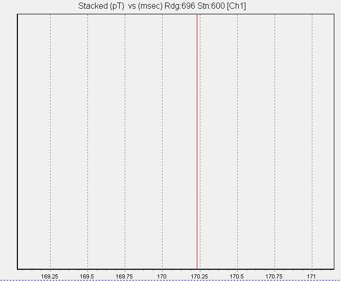

I've found that if I zoom in far enough on one of my charts, I get a vertical line (see attached) that does not appear to be from the data, as it doesn't move along the screen when I pan the chart with my mouse (and isn't there if I haven't zoomed in this far). There's a lot going on with the chart, so I wasn't able to reproduce the problem in a simple project. But, the problem does go away when I remove the line 'pLineSeries->XValues->Order = loNone;' so presumably that is related to the issue. The chart is plotting some 25,000 points of data.
Artifact

I was going to say that we'd need more information to reproduce it here but actually it appeared to be enough to create a line series with some thousands points and zooming three or four times it has been reproduced.
Here it is the simple code to reproduce it in a more stable way:
uses Series;
  Chart1.View3D:=false;
  Chart1.AddSeries(TLineSeries).FillSampleValues(10000);
  Chart1[0].XValues.Order:=loNone;
  Chart1.Axes.Bottom.SetMinMax(1000,1025);
So I've added it to the defect list to be revised asap (TV52015608).
