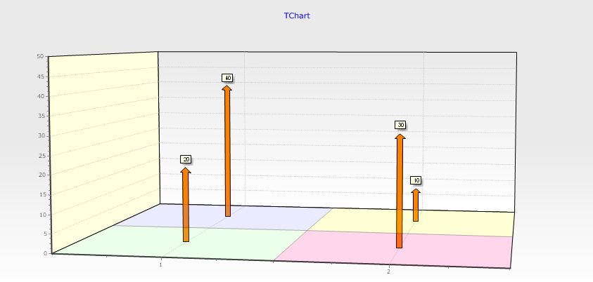

Is it possible to show a map series (normally shown on the x-y plane) on the x-z plane? I want to be able to show a map in 3d and then place another series on top of it using bars to show a numerical value for that shape. Like a bar showing the population densitity of an area, the average power usage, etc. I have created a screen shot using a 3d bar series for the 'map' (in this case all squares) and a 3d bar series showing the values for that area.

Hello Michael,
I've been trying to prepare an example with the actual features in TeeChart but it wouldn't be easy. I'd let you know if I achieve to get an acceptable example.
On the other hand, I've added it to the wish list to be implemented in future releases (TV52015714).

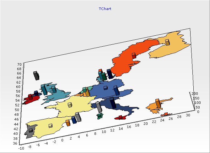

Hello Michael,
I finally got something that looks quite well:
uses TeCanvas;
var Map1: TWorldSeries;
    Sizes: array of Double;
var i: Integer;
  Chart1.Legend.Visible:=false;
  Chart1.Aspect.Orthogonal:=false;
  Chart1.Aspect.Elevation:=50;
  Chart1.Axes.Depth.Visible:=true;
  Chart1.Axes.Bottom.ZPosition:=100;
  Chart1.Axes.Left.ZPosition:=100;
  Chart1.Axes.Bottom.Grid.Visible:=false;
  Chart1.Axes.Left.Grid.Visible:=false;
  Chart1.Axes.Depth.Grid.Visible:=false;
  Chart1.Walls.Bottom.Visible:=false;
  Chart1.Walls.Left.Visible:=false;
  ScrollBar1.Max:=360;
  ScrollBar1.Position:=Chart1.Aspect.Elevation;
  Chart1.Axes.Depth.SetMinMax(-200,0);
  Map1:=Chart1.AddSeries(TWorldSeries) as TWorldSeries;
  Map1.Map:=wmEurope15;
  Map1.ColorEachPoint:=true;
  SetLength(Sizes, Map1.Count);
  for i:=0 to High(Sizes) do
    Sizes[i]:=Random()*100;
var i: Integer;
    XVal, YVal: Integer;
  for i:=0 to Map1.Count-1 do
    XVal:=Map1.Shapes[i].Bounds.Left + ((Map1.Shapes[i].Bounds.Right-Map1.Shapes[i].Bounds.Left) div 2);
    YVal:=Map1.Shapes[i].Bounds.Top + ((Map1.Shapes[i].Bounds.Bottom-Map1.Shapes[i].Bounds.Top) div 2);
    Chart1.Canvas.Brush.Color:=Map1.ValueColor[i];
    Chart1.Canvas.Cube(XVal-5, XVal+5, YVal-5, YVal+5, Chart1.Axes.Depth.IEndPos-Chart1.Axes.Depth.CalcSizeValue(Sizes[i]), Chart1.Axes.Depth.IEndPos);
procedure TForm1.Chart1GetAxisLabel(Sender: TChartAxis; Series: TChartSeries;
  ValueIndex: Integer; var LabelText: string);
  if Sender = Chart1.Axes.Depth then
    LabelText:=FloatToStr(Abs(StrToFloat(LabelText)));

Hello Yeray,
Sorry for not responding sooner, had some time off.
The solution you have provided will help me along the way. I am going to have to add features a normal bar series has but I think this is usable. I'll let you know once I have added your solution to my code. Thanks for the code example and the effort. It is quite an out of the box solution.
