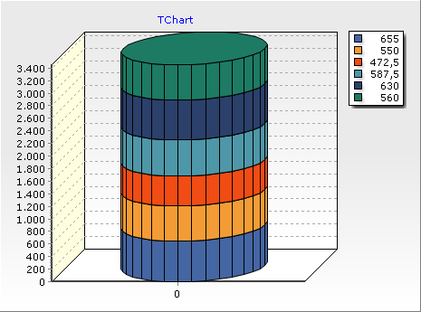

is it possible to create a chart that looks similar to that one I attached as an image? I mean the cylinder only. The tube surrounding the cylinder could be a backimage. I tried the cylinder series type but that doesn't look so smooth as in the image. And we don't want to use neither Open GL nor GDI+.
Thanks for your support!
Regards Markus

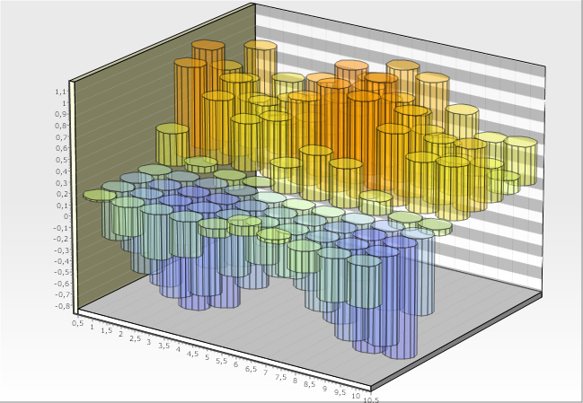

But how was this chart
created? This is an example from the steema gallery. Theses are also cylinders but they look very much better than the regular cylinder bar chart. Using the regular cylinder bar chart one have very few options to change the look of the cylinders. E.g. using a gradient fill.

Post by Yeray » Thu Oct 27, 2011 2:34 pm
Hello
This example from the gallery was made with TeeChart .NET and some of Micrsoft .NET Framework drawing techniques are not available in the VCL framework.
However, with GDI+ and the following code I get a quite similar result:
uses TeeSurfa, TeeGDIPlus, TeeTools;
  with TTeeGDIPlus.Create(self) do
    TeePanel:=Chart1;
    Active:=true;
  Chart1.Title.Visible:=false;
  Chart1.Chart3DPercent:=100;
  Chart1.Legend.Visible:=false;
  Chart1.Aspect.Orthogonal:=false;
  Chart1.Aspect.Zoom:=70;
  Chart1.Aspect.Rotation:=325;
  Chart1.Aspect.Elevation:=340;
  Chart1.Walls.Left.Size:=10;
  Chart1.Walls.Bottom.Size:=10;
  with Chart1.Tools.Add(TGridBandTool) as TGridBandTool do
    Axis:=Chart1.Axes.Left;
    Band1.Color:=clGrayText;
    Band1.Transparency:=50;
    Band2.Transparency:=50;
  with Chart1.AddSeries(TTowerSeries) as TTowerSeries do
    FillSampleValues();
    Origin:=YValues.MinValue+(YValues.MaxValue-YValues.MinValue)/2;
    UseOrigin:=true;
    TowerStyle:=tsCylinder;
    Marks.Visible:=false;
    Dark3D:=false;
    Transparency:=30;
    UseColorRange:=false;
    UsePalette:=true;
