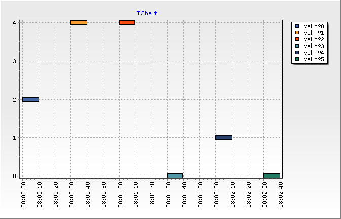

I have a need to create a gant looking chart for a series of of data points that are measured in seconds and span no more then 3 minutes. I tried manually adding some data, but the end date seems to always want to be an actual date. Is there a way to create a gant style chart with a series of 10 or so bars each back to back horizontally but only lasting a few seconds? thanks

The AddGantt method allows you to add each value with start and end date. You could use it to add your values with an end date a few seconds greater than the start date. Here you have an example using it:
uses GanttCh, DateUtils;
var tmpDate: TDateTime;
    i: Integer;
  Chart1.View3D:=false;
  Chart1.Legend.TextStyle:=ltsPlain;
  tmpDate:=StrToDateTime('01/01/2011 8:00:00');
  with Chart1.AddSeries(TGanttSeries) as TGanttSeries do
    for i:=0 to 5 do
      AddGantt(tmpDate,IncSecond(tmpDate,10),random(5), 'val nº' + IntToStr(i));
      tmpDate:=IncSecond(tmpDate,30);
  Chart1.Axes.Bottom.LabelsAngle:=90;
  Chart1.Axes.Bottom.DateTimeFormat:='hh:mm:ss';
  Chart1.Axes.Bottom.Increment:=DateTimeStep[dtTenSeconds];
  Chart1.Axes.Left.LabelStyle:=talValue;
