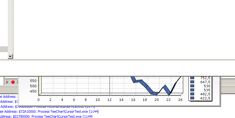

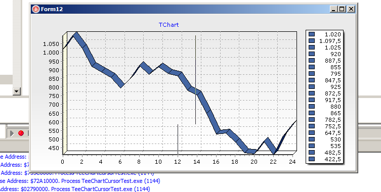

If I put another window partially covering the chart and the cursor, like here:
Then, when I take the chart back to the front and I try to drag the cursor tool, only the part that was hidden is repainted in the correct position:
If this is what you suffered, I could reproduce it with v2011.03 but not with the actual sources so it should be fixed with the next maintenance release. And the application doesn't seem to demand more CPU either.

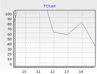

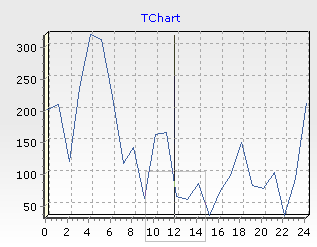

TheZoomRectangle
Post zoom, the cursor is now hidden
Is there a fix or workaround?

The two screen-shots are actual shots of the chart. The only modifications I made was to crop the form.
The first screen-shot is while I'm holding the left mouse button down just before releasing it, the rectangle is the zoom rectangle drawn by teechart.
The second is just after releasing the mouse button to zoom in.
The problem as you say is not consistent but this rectangle, on my machine at least, always renders the cursor invisible.
I've only found rectangles that hide the cursor that are very close to or go below the bottom axis.
