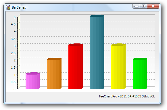

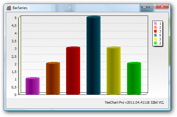

The release notes for version 2011.4.41118 don't mention the new Sides property for TBarSeries. Why are they not complete?
Anyway, although the property is a nice addition, but it makes the bar darker and it doesn't match the colours in the legend anymore.
Take a look at the images.
Also notice the light source. In the old version it looks as if it is coming from the left-front side. In the new version it looks there is a light source on the left and on the right.
Bert

Do you have enabled Dark3D? Is this a GDI+ project? We would appreciate if you attached a simple example project we can run "as-is" to reproduce the issue here.

Post by Narcís » Tue Nov 22, 2011 12:08 pm
Hi Bert,
Ok, I could reproduce the issue here increasing the sides property in your project and added your request to the wish-list (TV52015912) to be enhanced for future releases.
