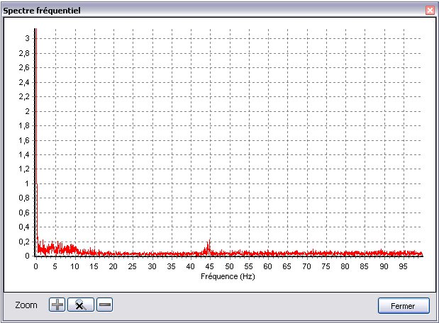

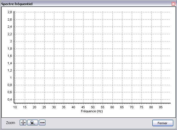

I use a simple zoompercent(110) on a chart (data origin on left and bottom axis are 0). After zooming in, data origin is changed, as if axes where scrolled (after a few tests, it looks like if zoompercent(110) performed a zoomrect at the center of my graph).
I tried to scroll axes, but I cannot get the value of the first visible graduation (tick) on the left axis (on the screenshot it is 0,4)...
How can I adjust my graph to get back my origin to (0,0) ?
Any idea is welcome !
original chart
after zooming in by 10%

When I perform
Chart1.ZoomPercent(110);
, the chart origin is changed from (0,0) to (0.4,10). I wanted to keep chart origin at (0,0).
