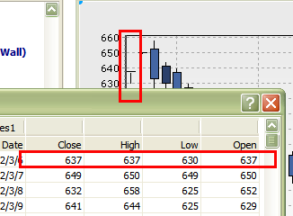

There is a problem in the attached image. The first data should be charted as a solid T shape, but the resulting vertical line turned out to shift 1 pixel downward that creates a disconnected gap. How can I fix that? thanks. (this one pixel gap gets even worse if I set Border.Visible := False)
A problem with candle series
- candle1.png (9.32 KiB) Viewed 11017 times

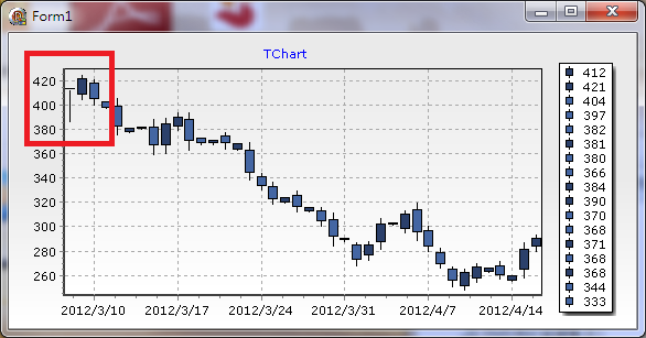

Please check the project's first data, thanks.
- CandleProblem.png (55.09 KiB) Viewed 10899 times
- CandleProblem.zip
- (66.25 KiB) Downloaded 923 times

Yes, but what you have mentioned is not the case that I reported. Allow me to explain this by taking the first attached image from top of this thread for example. First, the "Open value"=637 equals to "Close value", which is quite common in stock pricing, makes the rectangle part of OHLC look like a horizontal line. Second, the "High value" is also 637, which indicates that the "Open value" is also the highest among its period. This is again, frequently seen in stock pricing. Now the problem comes: If the top end of vertical line of OHLC, which is "High value", is disconnected to horizontal line and leaving a gap, it tells a story that the Open and Close values are even higher than defined "High value". That makes no sense to OHLC. So the chart must draw a perfect T in this case (and a perfect vertical inverted T for opposit case). Please correct me if there are mistakes, thanks.Yeray wrote:Hi,
