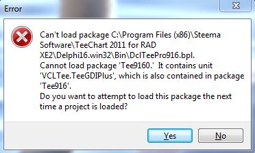

I am trying to install “TeeChart2011RADXE2” in my system, after installation when I open Delphi XE2 I get an error message says: "Please refer the image"
Can someone help me to fix this error?

Hi Lars,
First of all, please check you have the Update 3 installed in the IDE (and not the Update 4, as it is only supported with TeeChart source code for the moment).
The error message would indicate the Pro version can't be loaded because the Standard version shipped with the IDE is still being loaded and this is confusing the IDE. Please, go to the Packages list and make sure the Standard version is unchecked and then you should be able to select the Pro version in the same list.

Re: Problem in TeeChart Installation with Delphi XE2
We'd like to apologize for the inconveniences caused by the delay with the binary installers supporting XE2 Update 4. We are finalising the last details and I hope we'll be able to publish it very soon.
We've just published the TeeChart v2012.05 installer supporting XE2 Update 4.
http://www.teechart.net/support/viewtop ... 117#p57117
