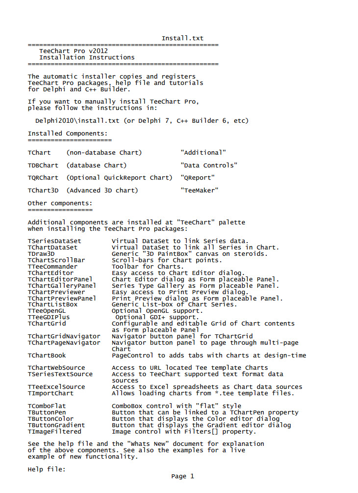

The Install.txt seems to be out of date, it states:
Delphi / C++ Builder:
In Delphi and C++ Builder you can recompile the TeeChart Pro packages opening the appropiate Project Group File (*.bpg)
BDS 2006: Tee9D10.bpg
Delphi 2005: Tee9D9.bpg
Delphi 7: Tee9D7.bpg
Delphi 6: Tee9D6.bpg
Delphi 5: Tee9D5.bpg
Delphi 4: Tee9D4.bpg
C++ Builder 6: Tee9BCB6.bpg
C++ Builder 5: Tee9BCB5.bpg
C++ Builder 4: Tee9BCB4.bpg
Double-click the first package ( ie: Tee97 ) and select
"Project -> Build All packages" to recompile all packages.
Please remove old package files and close all projects
before recompiling.
Is there a step-by-step procedure? Which bpg file should I open and from where. All of the ones I have tried have produced other errors

I would prefer to see better / more informative manual build / install instructions if that is possible. This would certainly reduce frustration. It is possible that the file 'Install.txt' (dated 21-Mar-2012) is out of date, or could benefit from additional steps in the detail. The end result from a source code install does not match the content of that document (copy attached).
I welcome any feedback
I uninstalled the source code version and installed the binary version (TeeChart2012RADXE2.exe), and the TGridChart component is available.
This tells me that the installation procedure for the source code distribution has a problem and needs to be examined (TeeChart2012SourceCode.exe).
