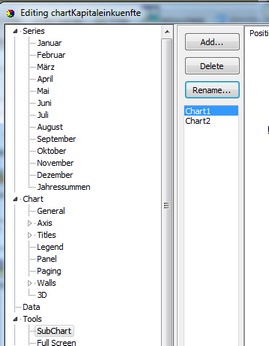

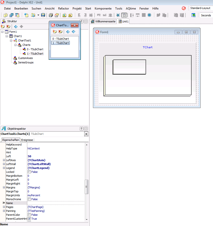

Hello Yeray,
your sample reproduces the error. Both Names of the TSubCharts are empty but i can compile and run your demo without futher error. That is very strange to me. My project has two empy TSubChart names and there is a EComponentError if I start my program with the error “A component named _1 already exists.”
I have attaches a picture to show you the empty name in your demo.
Your sincerely
Willi
Your sincerely
Willi
- Unbenannt.PNG (66.58 KiB) Viewed 9131 times
