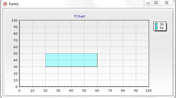

// This draws a correct shape
Series1.Clear;
Chart1.LeftAxis.SetMinMax( 0.0, 100.0 );
Chart1.BottomAxis.SetMinMax( 0.0, 100.0 );
Series1.X1 := 60;
Series1.Y1 := 50;
Series1.X0 := 20;
Series1.Y0 := 30;

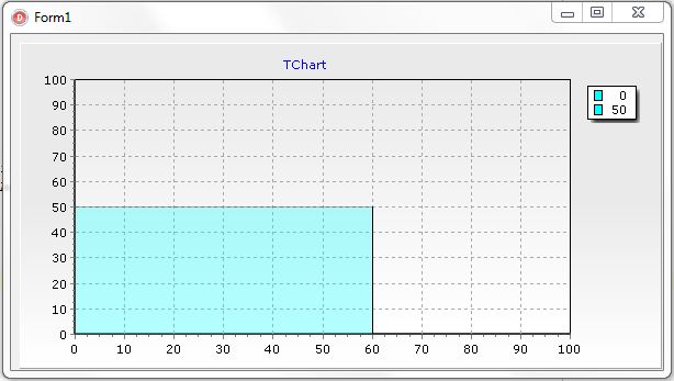

// Different sequence , draws an incorrect shape, see attached images
Series1.Clear;
Series1.X0 := 20;
Series1.Y0 := 30;
Series1.X1 := 60;
Series1.Y1 := 50;
TeeChart InCorrectShape.JPG (41.59 KiB) Viewed 3706 times
TeeChart CorrectShape.JPG (38.74 KiB) Viewed 3717 times
