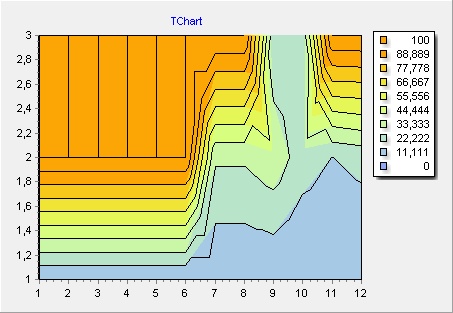

When I plot a contour graph, several areas have missing fill data (holes with no color)
The same code works correctly in a test program on Delphi XE2 using TeeChart v2012.05.120327. I have viewed other posts about holes in plots but could not resolve.

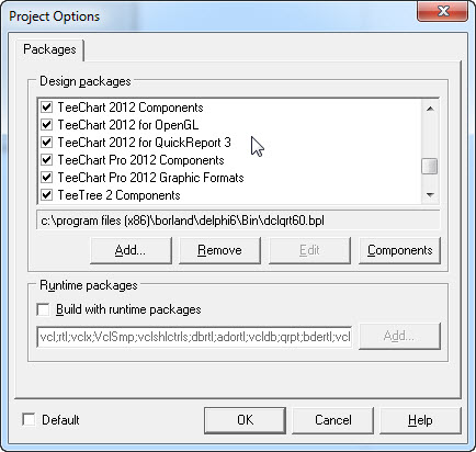

I went to Install Packages and removed all TeeChart components.
I ran the installation and Delphi shows these packages are installed:
20-Apr-12 5-39-47 AM.jpg (47.91 KiB) Viewed 5395 times

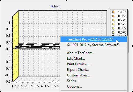

I open the project, and get this version number:
20-Apr-12 5-43-40 AM.jpg (54.58 KiB) Viewed 5382 times

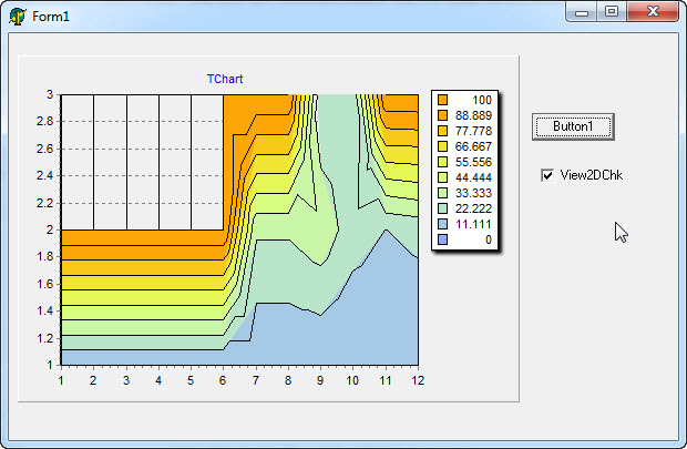

I completely rebuild the project and get this result:
20-Apr-12 5-44-55 AM.jpg (74.65 KiB) Viewed 5392 times
I deleted the DCU and the EXE file, rebuilt, checked dates OK etc, but same result. I deleted the RES file as well, same result.
Next, I opened the original project, removed the contour series and added another one, rebuilt, same result. no good
So I started a new project, added a TeeChart and Contour Series, and it worked OK! So where is the gremlin that is hanging on to some superseded code somewhere?
Anyway, bottom line, it's working, but there's something in that original project that is hanging on to an incorrect library or something. Do you have any 'cleanup' tips when upgrading?

I see you've checked the packages list, but have you checked the library and search paths?
If an old application behaves different than a new one (apparently running the same code), it usually indicates the old project is still referencing some old TeeChart installation. You can open the old project and check the library and search path lists. Check there's no reference to an old TeeChart installation and the correct ones are on the top of the lists.
If verifying/correcting the paths there doesn't still solve the problem, I'd close the project in the IDE, open the project files with notepad or similar and search & correct any wrong/old reference manually.
