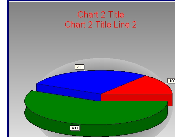

I installed the Mar 28 dnld and evrytime I run the exe I get an EEFACE -- this is an urgent matter as we are dead in water--we are using TEEChart in a very simple pie drawing in an Intraweb app...we previously had 2011 installed and it worked fine...also the pie chart does not fill properly on the left side -- it looks like two disks -- see attached pic

401kPensionGuru wrote:also the pie chart does not fill properly on the left side -- it looks like two disks -- see attached pic
Try with:
Series1.RotationAngle:=359;
